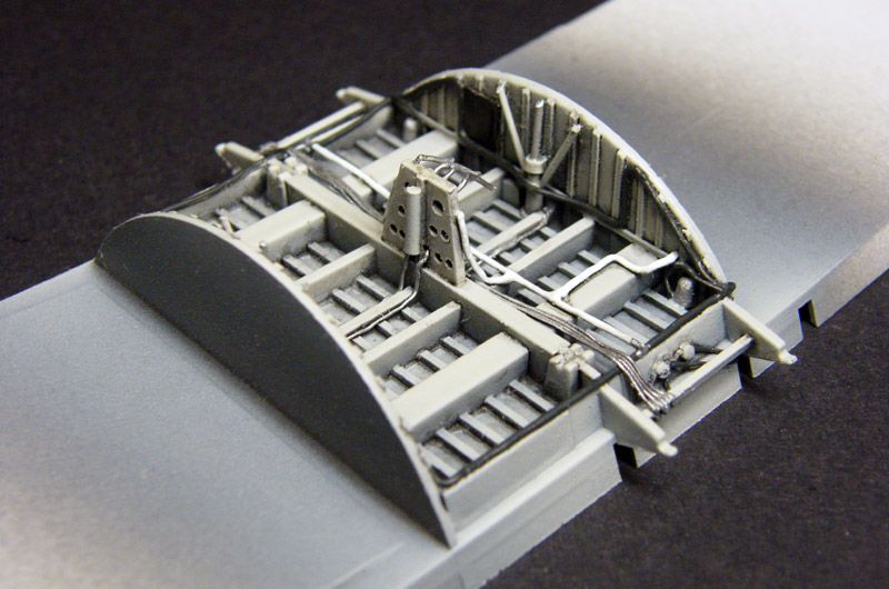

The landing gear bay had no detail whatsoever so that had to change.
Using plasticard, square rods, square tubing, and various size wires, I knuckled down to some scratch building.
Painting began by first giving the bay a primer/base colour of black. Then I airbrushed on the grey but predominantly hitting the area from one direction. This leaves some of the black in the nooks and crannies and creates a nice sense of depth and take care of a lot of the shading achieved by washes etc. (I was convinced I had photos of these stages but obviously not... apologies for that) I did add a pin wash at the end to pick out the details. I think it's a slight improvement on the kit part anyway. Shame most of it won't be seen :roll:

Holy Shite!!! [smilie=jaw-dropping.gif] what a shame to paint all the interior, that is bloody epic Vinny. landing gear bay is epic also this will be a really sweet build once complete in about 10 years at current pace :D
