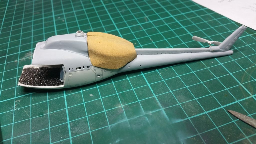

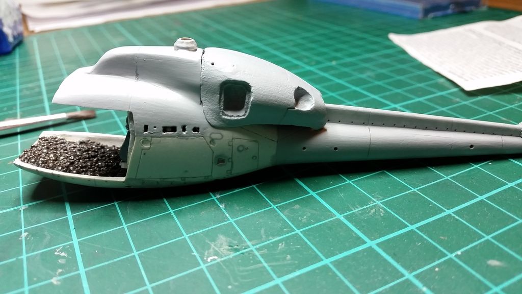

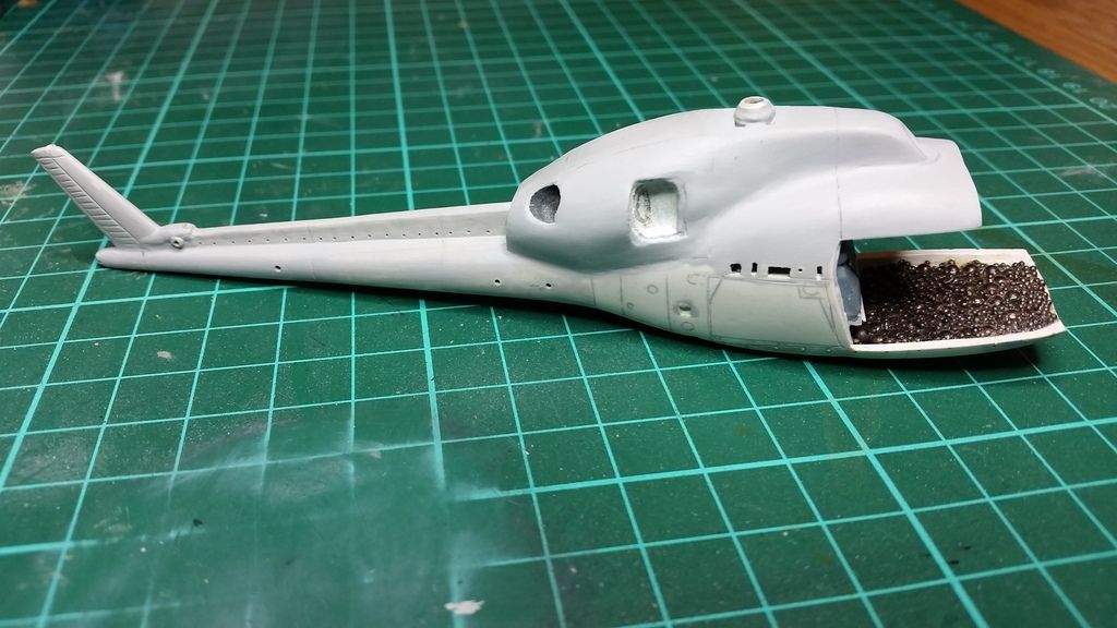

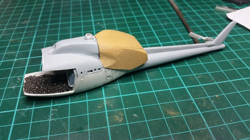

Filed & sanded the hardened Milliput to shape.
Then a few light coats of Mr. Surfacer & fine tune the shape.Still needs a bit of touch up in a few places.Another dry fit for a sconce of the progress.

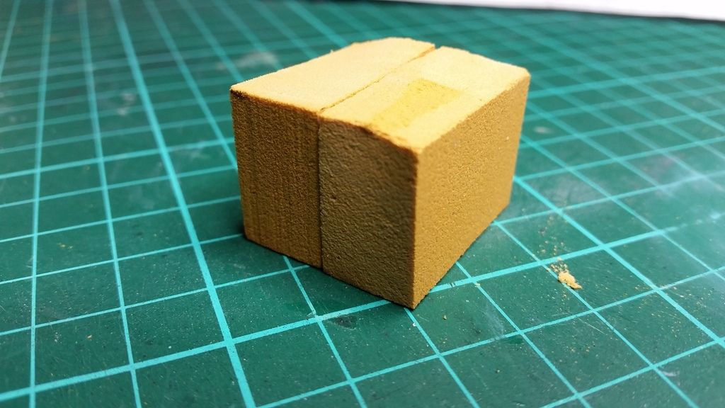

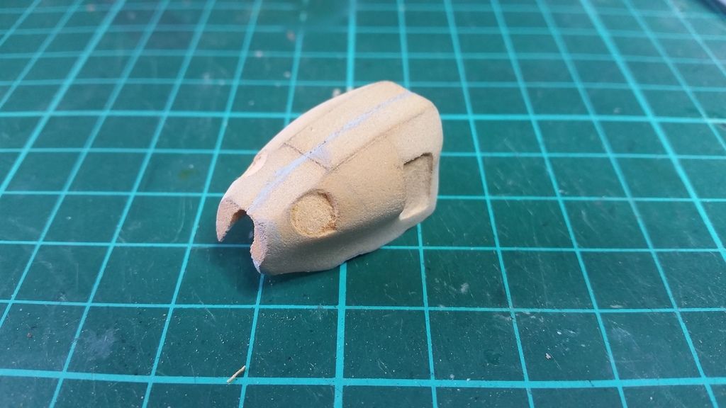

For the twin engine section I'm trying out something new to me.I got a sample of Balsa Foam from Spud.Thankyou Peter its great stuff to work with.It's like a finer honetcomb ala Cadbury's Crunchie but not as tasty.Cut to size & the two halves joined by double sided sticky tape.
Sanded to shape stage by stage.
I removed too much on the bottom lower sections so will use filler to fill the area & continue to sand to shape.
The engine section was given a few coats of Mr. Surfacer to seal the Balsafoam & eventually get a smooth finish on the part.Also the bottom section was removed .It will be built up with filler once connected to the fuselage.

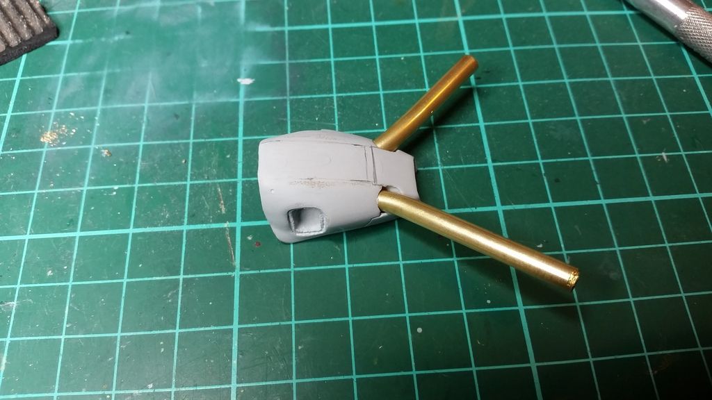

We had a BBQ during good weather so after the food was cooked a length of Albion Alloys finest 4mm brass tube was also put on the barbie.Then when it was nice n hot it was bent using a vice/vice grips & a nail stuck in the tube.Low tech but its all I could come up with for the job.The tube was then cut at the bend so I had two tubes with equal angles or thereabouts.
These were marked,then cut,grinded to shape & the inside also ground down to a finer edge using the power tool again.

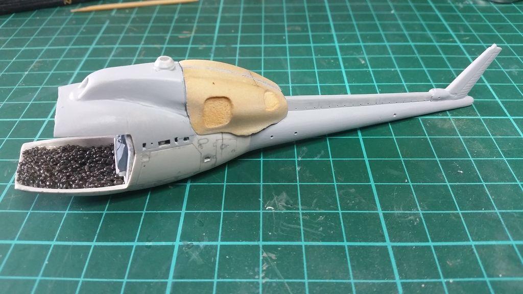

Here's what they look like loosely fitted.

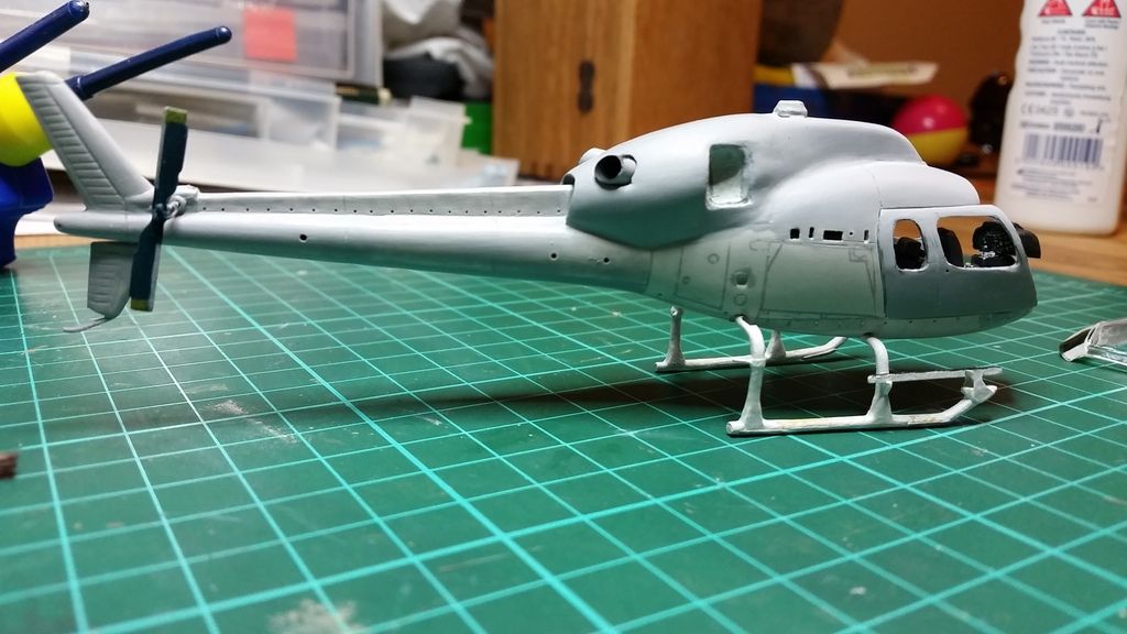

Current state of the Squirrel with most parts just loosly fitted
