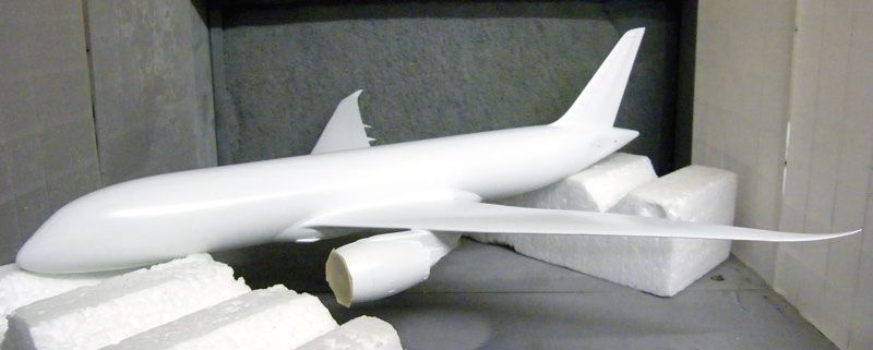

Personally, for my airliner whites, my favourite is Revell's gloss white enamel (No.04) as it's a bright white and doesn't yellow. I normally add a drop or two of gloss blue to the pot too to prevent any yellowing. Adding blue shifts the white towards the blue end of the spectrum and basically fools the eye. Adding about two drops of blue to the pot will give a nice cold brilliant white. Maybe the anti-flash white has a blue tint to it that's almost imperceptible?? I'd add three drops in that case. Don't be freaked out when the blue goes in, just keep stirring! I used that method for my 787 as the decal instructions stated a "cold white". I build up the white over a few days to prevent any heavy build-up and remove and dust between coats.
