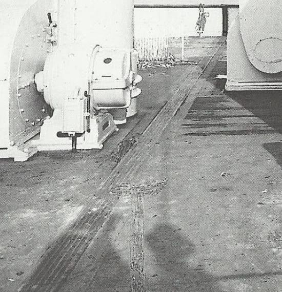

C'mere, I was watching a documentary on it the other night... is there a visible expansion joint on the model? Should be in or around the centre.
She had 2 expansion joints...1 between number 1 and 2 funnel and another further astern between numbers 3 and 4 funnels..at this scale they would be hard to see unless the margin planks are shown in the decking.

Ah, I didn't realise there were two expansion joints. I obviously wasn't paying attention to the documentary as I was engrossed in a masking job. It makes sense that the joints were in those positions as the joint between funnel 3 and 4 was the one the chaps in the docu where theorising about. They reckon that when the Titanic lifted out of the water it tore at that expansion joint and that if it didn't it wouldn't have gone down so fast and more people would have survived. They did a dive to the Britannic and found that H&W had changed the design of the expansion joints... but they kept that quiet.
You're right Luke, at that scale it probably isn't noticeable anyway... it would just be like a pen line in width I reckon. The line is shown in the photo below.
