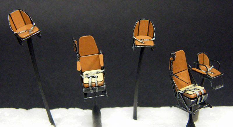

Postby Vinny » Sat Dec 31, 2016 10:21 pm
Hey Liam,
I use stretched sprue cut straight and with a tiny drop of CA super glue. I attach it to the parts where no paint is needed and when I'm done I just snap them off. The CA comes off pretty easy. It works great fro airbrushing but also can hold the object for detailed painting.
