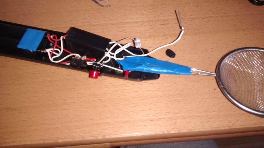

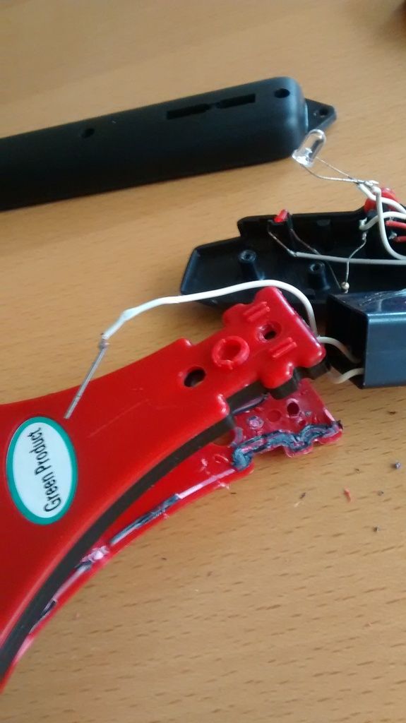

So what you need for this is some electric cable, some duct tape, a small metal sieve (i bought 3 for 3 euro) and the most important electric fly zapper:
I didn't find any in Dublin, so i have to order from UK i find on eBay it was 3 euro or something like that..

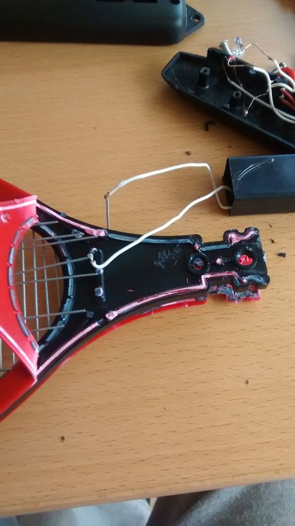

After when you open your zapper you have to remove the red parts:

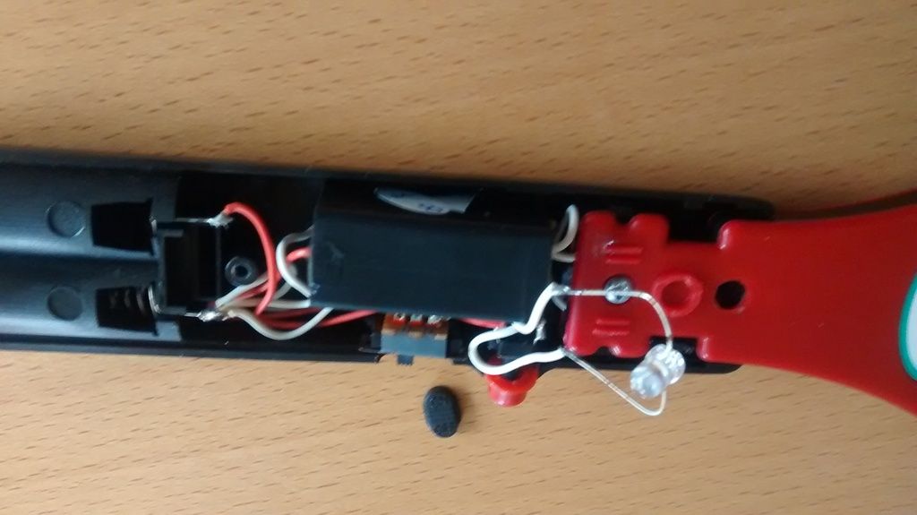

There is to small piece of cable what you need later come out from a little black box:

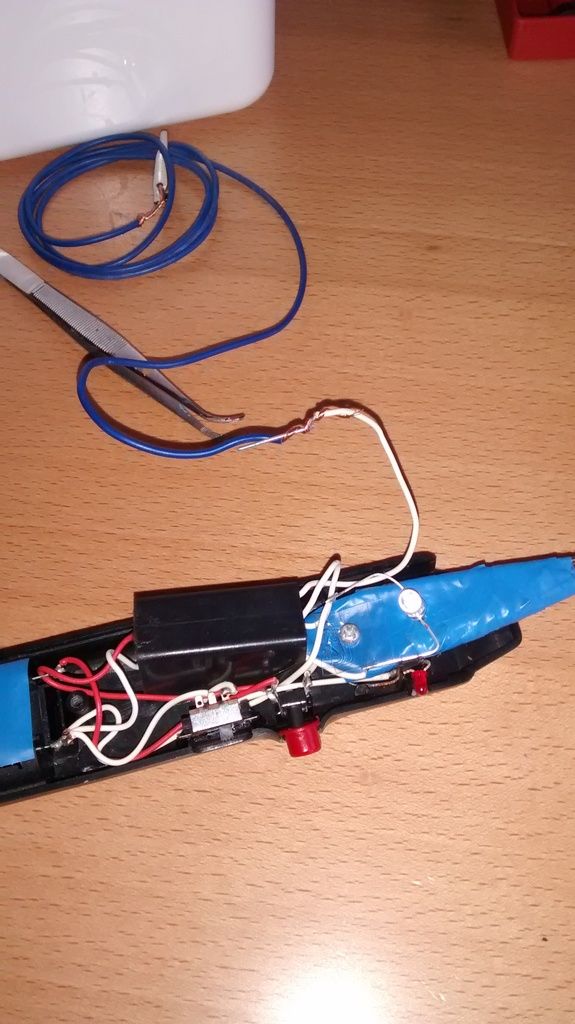

You have to connect one of the cable with the sieve, i use a lots of tape there just in case :)
After this you still have one cable, you have to make a bit longer:
I add a alligator clip to the end of the cable, its gonna by useful.

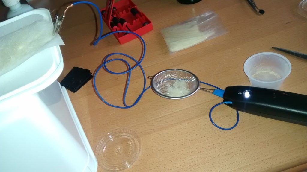

All the job done, just put the parts together, and your grass aplicator is ready to use [smilie=banana.gif]

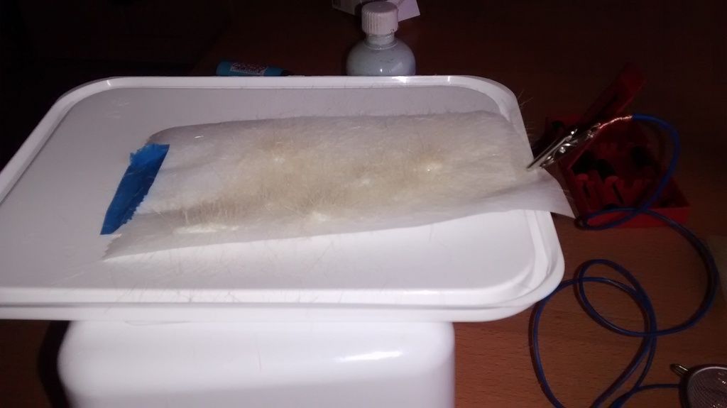

Connect the clip to the area where you want the sexy grass, put the grass mixture in the sieve and turn on:

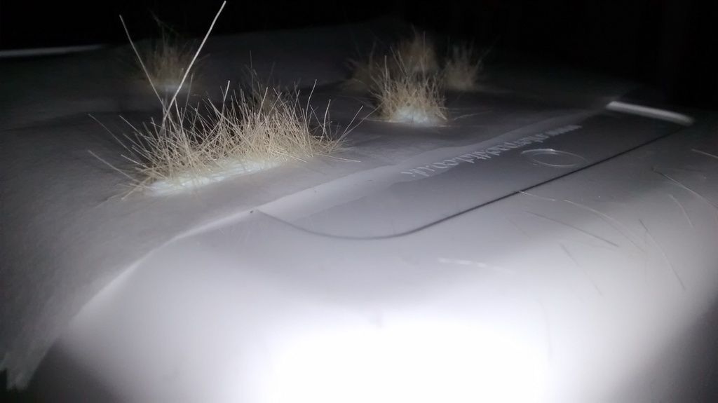

Looks very messy in first time, but i remove the extra grass and i there is a finished product
Next time i try a different grass this one is very soft and thin, but i think looks good enough for a first try [smilie=thumb.gif]
